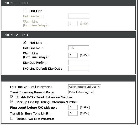

Как правильно настроить прямое поступление звонков из PSTN на FXS порт? т.к. используется и настроен только FXS на SIP сервере, и нужно принимать входящие звонки с PSTN напрямую.
Настроил по http://dlink.ua/ru/voip_solutions_10 , результат при звонке с PSTN на шлюз - занято
лог:
13:18:49 [001543] 0: 555=REGISTER
13:18:49 [001547] 0: 555=REGISTER_AUTHN
13:18:49 [001549] 0: 555=REGISTERED
13:19:11 [000033] Receive Cmd=1100, ParaLen=5, Para=[Login]
13:19:11 [000033] Login RU_1.00 == Ver(1.02.38.54.2846 2010/04/15 17:34:03) PId(281.DLink.RU.DecodeProf.DhcpOpt195.l2tp.DualAccess.NoPrefix.drtp) Drv(0.10.47.1
13:19:11 ) Hw(TSO) == 0.6.8
13:19:15 [000074] LocalIP=[10.1.1.2]
13:19:18 [000104] SetTosDscp(68,b8)
13:19:18 [000106] 0: ContactAddr=[<sip:555@10.1.1.2:5060>]
13:19:18 [000106] 1: ContactAddr=[<sip:347347345734634@10.1.1.2:5060>]
13:19:18 [000106] 3: ContactAddr=[<sip:10.1.1.2:5060>]
13:19:18 [000108] 0: 555=REGISTER
13:19:18 [000108] SipLineRegStatus=0010444
13:19:18 [000108] OtSip_Init OK
13:19:19 [000111] 0: 555=REGISTER_AUTHN
13:19:19 [000113] 0: 555=REGISTERED
13:19:19 [000113] SipLineRegStatus=0020444
13:19:23 [000159] NetLink(0) On
13:19:23 [000159] NetLink(1) Off
13:19:23 [000159] NetLink(2) Off
13:19:23 [000159] NetLink(3) Off
13:19:23 [000159] NetLink(4) Off
13:19:51 [000432] 1: Fxo Ringing
13:19:51 [000432] 1: CallerId=
13:19:51 [000432] 1: ==17:WaitAnswerDeviceOk
13:19:51 [000433] 1: HotLineEnabled with [555]
13:19:51 [000433] 1: End Input Default Route [2]
13:19:51 [000433] 1: Local Calling Fxo [555]
13:19:51 [000433] 1: ==7:Inviting
13:19:51 [000433] 1: No Free Fxo Line
13:19:51 [000433] 1: Offhook Fxo for PlayBusy
13:19:51 [000433] 1: FxoHookOff
13:19:51 [000433] 1: InputGain(0)
13:19:51 [000433] 1: ==15:PlayBusyTone
13:19:54 [000463] 1: FxoHookOn
13:19:54 [000463] 1: ==3:Idle
13:19:54 [000463] 1: InputGain(6)
13:19:54 [000464] 1: SetFax(1)=0
13:19:54 [000464] 1: SetModem(0)=-1
set.png [ 11.92 KiB | Просмотров: 7611 ]

Сам отвечаю: Нужно прописать кроме хотлайна еще и:
ADVANCED -> VOIP -> Digit Map
Scan Code: ваш_номер_FXS (Phone 1 - FXS)
VoIP Dial-out: ваш_номер_FXS (Phone 1 - FXS)
PSTN Dial-out:
User Dial Length: Disable
Route: VoIP

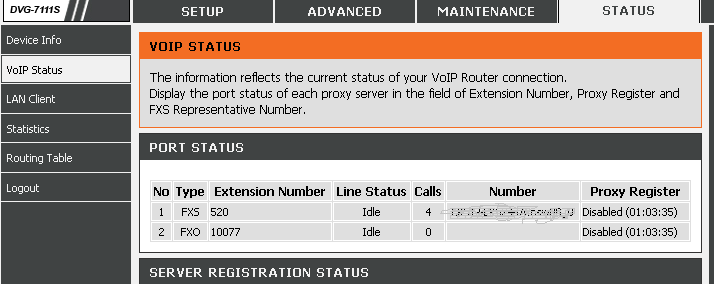

Стоит несколько шлюзов 7111s(FXS+FXO), возникает проблема: теряют регистрацию(предположительно после кратковременного отключения интернет) шлюзы ходят в интернет через ADSL роутер, на них настроен PPTP dual-access к серверу win2003 ) и не предпринимают попыток переподключения.
лог слит в 9:08
07:53:18 [815716] 0: 520=REGISTER
07:53:18 [815718] 0: 520=REGISTER_AUTHN
07:53:19 [815720] 0: 520=REGISTERED
07:53:20 [815732] 1: 10077=REGISTER
07:53:20 [815734] 1: 10077=REGISTER_AUTHN
07:53:20 [815736] 1: 10077=REGISTERED
08:01:57 [820900] Receive Cmd=1100, ParaLen=5, Para=[Login]
08:01:57 [820900] Login RU_1.00 == Ver(1.02.38.54.2846 2010/04/15 17:34:03) PId(281.DLink.RU.DecodeProf.DhcpOpt195.l2tp.DualAccess.NoPrefix.drtp) Drv(0.10.47.1
08:01:57 ) Hw(TSO) == 0.6.8
08:01:59 [820923] ********** SocketGetInterfaceIp Error **********
08:01:59 [820923] Quit
08:01:59 [820923] UnregisterAll
08:01:59 [820924] 0: 520=REGISTER
08:01:59 [820924] SipLineRegStatus=0012444
08:01:59 [820924] 1: 10077=REGISTER
08:01:59 [820924] SipLineRegStatus=0011444
08:01:59 [820926] 0: 520=REGISTER_AUTHN
08:01:59 [820927] 1: 10077=REGISTER_AUTHN
08:01:59 [820928] 0: 520=REGISTERED
08:02:00 [820929] 1: 10077=REGISTERED
08:02:07 [000058] Receive Cmd=1100, ParaLen=5, Para=[Login]
08:02:07 [000058] Login RU_1.00 == Ver(1.02.38.54.2846 2010/04/15 17:34:03) PId(281.DLink.RU.DecodeProf.DhcpOpt195.l2tp.DualAccess.NoPrefix.drtp) Drv(0.10.47.1
08:02:07 ) Hw(TSO) == 0.6.8
08:02:16 [000151] NetLink(0) On
08:02:16 [000151] NetLink(1) Off
08:02:16 [000151] NetLink(2) Off
08:02:16 [000151] NetLink(3) Off
08:02:16 [000151] NetLink(4) Off
После этого времени как минимум в течении часа никаких сообщений не записывается
Лог слит в 9.08
HELP!!! :?
9.06.7111_120png.png [ 11.9 KiB | Просмотров: 7591 ]
