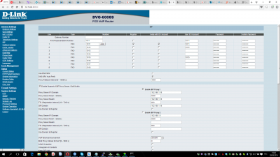

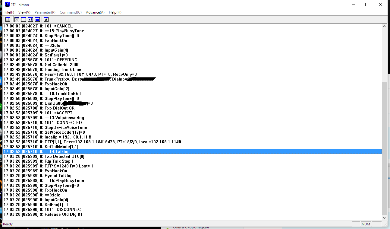

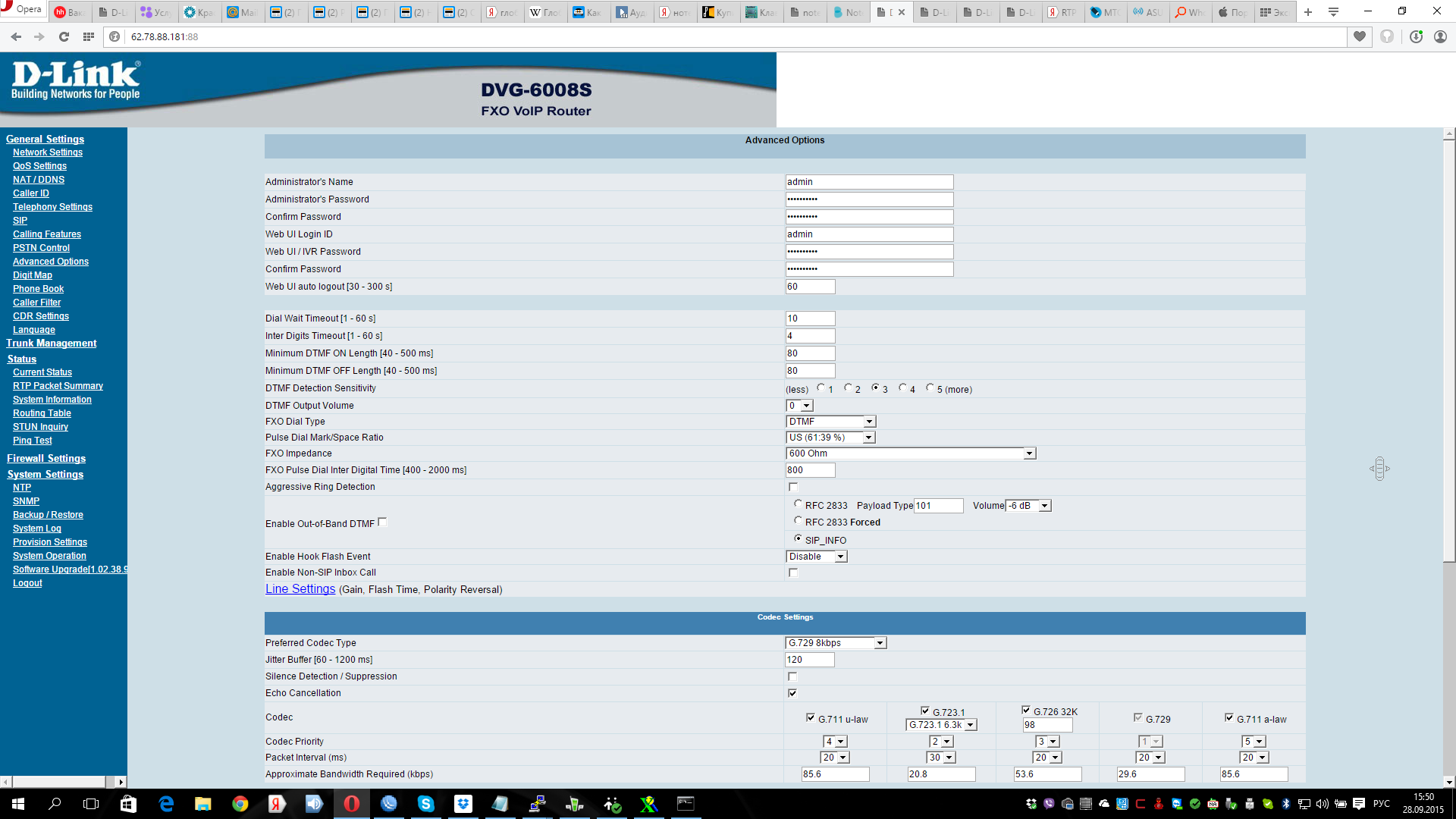

Вот скрины:
Комментарий к файлу: slmon log
456.png [ 48.1 KiB | Просмотров: 7862 ]
Скриншот 2015-09-28 15.50.44.png [ 227.76 KiB | Просмотров: 7868 ]
Скриншот 2015-09-28 15.42.42.png [ 215.83 KiB | Просмотров: 7868 ]

Какая верси прошивки на шлюзе? и нужен дамп трафика со шлюза.
Если дамп снять не получится, то лог slmon с командами: Advance -> Manual Command -> Command Code 999 и Parametr 1

Current Software Version No. [1.02.38.95]
Логи с командами Command Code 999 и Parametr 1:
18:25:24 [011016] Receive Cmd=999, ParaLen=1, Para=[1]
18:25:30 [011082]
18:25:30 [011082] User-Agent: Asterisk PBX 11.7.0~dfsg-1ubuntu1
18:25:30 [011082] Date: Fri, 02 Oct 2015 15:25:39 GMT
18:25:30 [011082] a=rtpmap:18 G729/8000
18:25:31 [011082]
18:25:31 [011083] Content-Type: application/sdp
18:25:31 [011083] 9: 1011=OFFERING
18:25:31 [011083] 9: Get CallerId=2000
18:25:31 [011083] 9: Hunting Trunk Line
18:25:31 [011083] 0: Peer=192.168.1.18#12720, PT=18, RecvOnly=0
18:25:31 [011083] 0: TrunkPrefix=, Dest=83852251906, Dialno=83852251906
18:25:31 [011083] 0: FxoHookOff
18:25:31 [011083] 0: InputGain(-2)
18:25:31 [011083] 0: ==18:TrunkDialOut
18:25:31 [011084]
18:25:31 [011084] <---- 192.168.1.18:5060
18:25:31 [011084] INVITE sip:83852251906@192.168.1.11 SIP/2.0
18:25:31 [011084] Via: SIP/2.0/UDP 192.168.1.18:5060;branch=z9hG4bK45a823b5;rport
18:25:31 [011084] Max-Forwards: 70
18:25:31 [011084] From: "2000" <sip:2000@192.168.1.18>;tag=as7e6d9aec
18:25:31 [011084] To: <sip:83852251906@192.168.1.11>
18:25:31 [011084] Contact: <sip:2000@192.168.1.18:5060>
18:25:31 [011084] Call-ID: 31c492d014853a185e9ef5ad19e7e69d@192.168.1.18:5060
18:25:31 [011084] CSeq: 102 INVITE
18:25:31 [011084] User-Agent: Asterisk PBX 11.7.0~dfsg-1ubuntu1
18:25:31 [011084] Date: Fri, 02 Oct 2015 15:25:39 GMT
18:25:31 [011084] Allow: INVITE, ACK, CANCEL, OPTIONS, BYE, REFER, SUBSCRIBE, NOTIFY, INFO, PUBLISH
18:25:31 [011084] Supported: replaces, timer
18:25:31 [011084] Content-Type: application/sdp
18:25:31 [011084] Content-Length: 341
18:25:31 [011084] v=0
18:25:31 [011084] o=root 678091587 678091587 IN IP4 192.168.1.18
18:25:31 [011084] s=Asterisk PBX 11.7.0~dfsg-1ubuntu1
18:25:31 [011084] c=IN IP4 192.168.1.18
18:25:31 [011084] t=0 0
18:25:31 [011084] m=audio 12720 RTP/AVP 18 3 0 8 101
18:25:31 [011084] a=rtpmap:18 G729/8000
18:25:31 [011084] a=fmtp:18 annexb=no
18:25:31 [011084] a=rtpmap:3 GSM/8000
18:25:31 [011084] a=rtpmap:0 PCMU/8000
18:25:31 [011084] a=rtpmap:8 PCMA/8000
18:25:31 [011084] a=rtpmap:101 telephone-event/8000
18:25:31 [011084] a=fmtp:101 0-16
18:25:31 [011084] a=ptime:20
18:25:31 [011084] a=sendrecv
18:25:31 [011084] -----
18:25:31 [011084]
18:25:31 [011084]
18:25:31 [011084] ----> 192.168.1.18:5060
18:25:31 [011084] SIP/2.0 100 Trying
18:25:31 [011084] Via: SIP/2.0/UDP 192.168.1.18:5060;rport;branch=z9hG4bK45a823b5
18:25:31 [011085] Call-ID: 31c492d014853a185e9ef5ad19e7e69d@192.168.1.18:5060
18:25:31 [011085] CSeq: 102 INVITE
18:25:31 [011085] Content-Type: application/sdp
18:25:31 [011085] Content-Length: 0
18:25:31 [011085] -----
18:25:31 [011085]
18:25:32 [011094] 0: StopPlayTone()=0
18:25:32 [011094] 0: DialOut(83852251906)=0
18:25:34 [011114] 9: 1011=ACCEPT
18:25:34 [011114] 0: ==13:VoipAnswering
18:25:34 [011115]
18:25:34 [011115] ----> 192.168.1.18:5060
18:25:34 [011115] Via: SIP/2.0/UDP 192.168.1.18:5060;rport;branch=z9hG4bK45a823b5
18:25:34 [011115] s=Session SDP
18:25:34 [011116] 9: 1011=CONNECTED
18:25:34 [011116] 0: StopDeviceVoiceTone
18:25:34 [011116] 0: SetVoiceCoder(17)=0
18:25:34 [011116] 0: localip = 192.168.1.11 !!
18:25:34 [011116] 0: RTP[1,1], Peer=192.168.1.18#12720, PT=18/2/0, local=192.168.1.11#0
18:25:34 [011116] 0: SetTalkMode[1,1]
18:25:34 [011116] 0: ==14:Talking
18:25:50 [011280]
18:25:50 [011280] <---- 192.168.1.18:5060
18:25:50 [011280] BYE sip:1011@192.168.1.11:5060 SIP/2.0
18:25:50 [011280] Via: SIP/2.0/UDP 192.168.1.18:5060;branch=z9hG4bK21597f57;rport
18:25:50 [011280] Max-Forwards: 70
18:25:50 [011280] From: "2000" <sip:2000@192.168.1.18>;tag=as7e6d9aec
18:25:50 [011280] To: <sip:83852251906@192.168.1.11>;tag=656da054-685920
18:25:50 [011280] Call-ID: 31c492d014853a185e9ef5ad19e7e69d@192.168.1.18:5060
18:25:50 [011280] CSeq: 103 BYE
18:25:50 [011280] User-Agent: Asterisk PBX 11.7.0~dfsg-1ubuntu1
18:25:50 [011280] X-Asterisk-HangupCause: Normal Clearing
18:25:50 [011280] X-Asterisk-HangupCauseCode: 16
18:25:50 [011280] Content-Length: 0
18:25:50 [011280] -----
18:25:50 [011280]
18:25:50 [011281]
18:25:50 [011281] ----> 192.168.1.18:5060
18:25:50 [011281] SIP/2.0 481 Call Leg/Transaction Does Not Exist
18:25:50 [011281] Via: SIP/2.0/UDP 192.168.1.18:5060;rport;branch=z9hG4bK21597f57
18:25:50 [011281] From: "2000" <sip:2000@192.168.1.18>;tag=as7e6d9aec
18:25:50 [011281] To: <sip:83852251906@192.168.1.11>;tag=656da054-685920
18:25:50 [011281] Call-ID: 31c492d014853a185e9ef5ad19e7e69d@192.168.1.18:5060
18:25:50 [011281] CSeq: 103 BYE
18:25:51 [011281] User-Agent: dlink 12-3895-8558-1.2.1.2178-SA7O8
18:25:51 [011281] Content-Length: 0
18:25:51 [011281] -----
18:25:51 [011281]

А трубка не высвобождается. Висела пока я не послал в линию шлюза "BUSY".
А теперь ещё интереснее. Когда звонок обратный, т.е. НА ШЛЮЗ и СИП КЛИЕНТ вешает трубку - BYE. Звонок успешно завершается.
19:12:18 [039153]
19:12:18 [039153] ----> 192.168.1.18:5060
19:12:18 [039153] SIP/2.0 200 OK
19:12:18 [039153] Content-Length: 0
19:12:50 [039479] 0: Fxo Ringing
19:12:50 [039480] 0: RingTime(1040) First Stop
19:12:52 [039495] 0: RingTime(2600) Second Ring
19:12:54 [039517] 0: StopPlayTone()=0
19:12:54 [039517] 0: ### Fxo Get Fsk CallerId [3852380498,], Len=10
19:12:54 [039517] 0: CallerId=3852380498
19:12:54 [039517] 0: ==17:WaitAnswerDeviceOk
19:12:54 [039518] 0: StopDeviceVoiceTone
19:12:54 [039518] 0: HotLineEnabled with [1011]
19:12:54 [039518] 0: End Input Default Route [1]
19:12:54 [039518] 0: PhoneBook has GwNo=1011, addr=192.168.1.18:5060
19:12:54 [039518] 0: ==7:Inviting
19:12:54 [039518] 0: VoIP CallOut, Invite <sip:1011@192.168.1.18;user=phone>
19:12:54 [039519] 0: 1011=DIALING
19:12:54 [039520]
19:12:54 [039520] ----> 192.168.1.18:5060
19:12:54 [039520] INVITE sip:1011@192.168.1.18;user=phone SIP/2.0
19:12:54 [039520] Via: SIP/2.0/UDP 192.168.1.11:5060;branch=z9hG4bK4c108ea9ebaec5ee
19:12:54 [039520] From: <sip:3852380498@192.168.1.18;user=phone>;tag=70fc2158-688760
19:12:54 [039520] To: <sip:1011@192.168.1.18;user=phone>
19:12:54 [039520] Call-ID: D1B9-121C-4668876030B5C11A538A-002@SipHost
19:12:54 [039520] Session-Expires: 100
19:12:54 [039520]
19:12:54 [039520] <---- 192.168.1.18:5060
19:12:54 [039520] SIP/2.0 401 Unauthorized
19:12:54 [039520] Via: SIP/2.0/UDP 192.168.1.11:5060;branch=z9hG4bK4c108ea9ebaec5ee;received=192.168.1.11;rport=5060
19:12:54 [039520] Allow: INVITE, ACK, CANCEL, OPTIONS, BYE, REFER, SUBSCRIBE, NOTIFY, INFO, PUBLISH
19:12:54 [039522]
19:12:54 [039522] ----> 192.168.1.18:5060
19:12:54 [039522] ACK sip:1011@192.168.1.18;user=phone SIP/2.0
19:12:54 [039522] Via: SIP/2.0/UDP 192.168.1.11:5060;branch=z9hG4bK4c108ea9ebaec5ee
19:12:54 [039522] From: <sip:3852380498@192.168.1.18;user=phone>;tag=70fc2158-688760
19:12:54 [039522] To: <sip:1011@192.168.1.18;user=phone>;tag=as11904a0c
19:12:54 [039522] Call-ID: D1B9-121C-4668876030B5C11A538A-002@SipHost
19:12:54 [039522] CSeq: 16 INVITE
19:12:54 [039522] Content-Type: application/sdp
19:12:54 [039522] Content-Length: 331
19:12:54 [039522] v=0
19:12:54 [039522] o=1011 1795955420 1795955420 IN IP4 192.168.1.11
19:12:55 [039522] s=Session SDP
19:12:55 [039522] c=IN IP4 192.168.1.11
19:12:55 [039522] t=0 0
19:12:55 [039522] m=audio 11000 RTP/AVP 18 4 98 0 8
19:12:55 [039522] a=rtpmap:98 G726-32/8000
19:12:55 [039523]
19:12:55 [039523] <---- 192.168.1.18:5060
19:12:55 [039523] SIP/2.0 401 Unauthorized
19:12:55 [039523] Via: SIP/2.0/UDP 192.168.1.11:5060;branch=z9hG4bK4c108ea9ebaec5ee;received=192.168.1.11;rport=5060
19:12:55 [039523] From: <sip:3852380498@192.168.1.18;user=phone>;tag=70fc2158-688760
19:12:55 [039523] To: <sip:1011@192.168.1.18;user=phone>;tag=as11904a0c
19:12:55 [039523] Call-ID: D1B9-121C-4668876030B5C11A538A-002@SipHost
19:12:55 [039523] CSeq: 15 INVITE
19:12:55 [039523] Server: Asterisk PBX 11.7.0~dfsg-1ubuntu1
19:12:55 [039523] Allow: INVITE, ACK, CANCEL, OPTIONS, BYE, REFER, SUBSCRIBE, NOTIFY, INFO, PUBLISH
19:12:55 [039523] Supported: replaces, timer
19:12:55 [039523] WWW-Authenticate: Digest algorithm=MD5, realm="taxi2.asuscomm.com", nonce="2b8cc9a2"
19:12:55 [039523] Content-Length: 0
19:12:55 [039523] -----
19:12:55 [039523]
19:12:55 [039523]
19:12:55 [039523] ----> 192.168.1.18:5060
19:12:55 [039523] ACK sip:1011@192.168.1.18;user=phone SIP/2.0
19:12:55 [039524] SIP/2.0 100 Trying
19:12:55 [039524] Contact: <sip:1011@192.168.1.18:5060>
19:12:55 [039524] 0: 1011=PROCEEDING
19:13:10 [039674]
19:13:10 [039674] <---- 192.168.1.18:5060
19:13:10 [039674] SIP/2.0 200 OK
19:13:10 [039674] Via: SIP/2.0/UDP 192.168.1.11:5060;branch=z9hG4bKa37a3924345d70ba;received=192.168.1.11;rport=5060
19:13:10 [039674] From: <sip:3852380498@192.168.1.18;user=phone>;tag=70fc2158-688760
19:13:10 [039674] To: <sip:1011@192.168.1.18;user=phone>;tag=as4706fd59
19:13:10 [039674] Session-Expires: 100;refresher=uas
19:13:10 [039674] a=fmtp:18 annexb=no
19:13:10 [039676] 0: FxoHookOff
19:13:10 [039676]
19:13:10 [039676] Call-ID: D1B9-121C-4668876030B5C11A538A-002@SipHost
19:13:10 [039677]
19:13:10 [039678]
19:13:10 [039678] ----> 192.168.1.18:5060
19:13:10 [039678] ACK sip:1011@192.168.1.18:5060 SIP/2.0
19:13:10 [039678] Via: SIP/2.0/UDP 192.168.1.11:5060;branch=z9hG4bK1ad55a791db621e2
19:13:10 [039678] Call-ID: D1B9-121C-4668876030B5C11A538A-002@SipHost
19:13:17 [039754]
19:13:17 [039754] <---- 192.168.1.18:5060
19:13:18 [039754] OPTIONS sip:1011@192.168.1.11:5060 SIP/2.0
19:13:18 [039754] Contact: <sip:asterisk@192.168.1.18:5060>
19:13:18 [039754]
19:13:18 [039754] ----> 192.168.1.18:5060
19:13:18 [039754] SIP/2.0 200 OK
19:13:18 [039754] Via: SIP/2.0/UDP 192.168.1.18:5060;rport;branch=z9hG4bK7cd6845f
19:13:18 [039754] From: "asterisk" <sip:asterisk@192.168.1.18>;tag=as3e2372a2
19:13:18 [039754] To: <sip:1011@192.168.1.11:5060>;tag=ade2b841-688784
19:13:18 [039754] Call-ID: 3e9aa3de513ec83c4585deb05668a676@192.168.1.18:5060
19:13:18 [039754] CSeq: 102 OPTIONS
19:13:18 [039754] -----
19:13:18 [039755]
19:13:21 [039787]
19:13:21 [039787] <---- 192.168.1.18:5060
19:13:21 [039787] BYE sip:1011@192.168.1.11:5060 SIP/2.0
19:13:21 [039787] Via: SIP/2.0/UDP 192.168.1.18:5060;branch=z9hG4bK7c65c124;rport
19:13:21 [039787] Max-Forwards: 70
19:13:21 [039787] From: <sip:1011@192.168.1.18;user=phone>;tag=as4706fd59
19:13:21 [039787] To: <sip:3852380498@192.168.1.18;user=phone>;tag=70fc2158-688760
19:13:21 [039787] Call-ID: D1B9-121C-4668876030B5C11A538A-002@SipHost
19:13:21 [039787] CSeq: 102 BYE
19:13:21 [039787] User-Agent: Asterisk PBX 11.7.0~dfsg-1ubuntu1
19:13:21 [039787] Proxy-Authorization: Digest username="1011", realm="taxi2.asuscomm.com", algorithm=MD5, uri="sip:192
19:13:21 [039788] .168.1.18", nonce="2b8cc9a2", response="d07a258f24bee1861cf7d2adc0b3f108"
19:13:21 [039788] X-Asterisk-HangupCause: Unknown
19:13:21 [039788] X-Asterisk-HangupCauseCode: 0
19:13:21 [039788] Content-Length: 0
19:13:21 [039788] -----
19:13:21 [039788]
19:13:21 [039788] 0: 1011=DISCONNECT
19:13:21 [039788] 0: Rtp Talk Stop !
19:13:21 [039788] 0: ==15:PlayBusyTone
19:13:21 [039788]
19:13:21 [039789] Via: SIP/2.0/UDP 192.168.1.18:5060;rport;branch=z9hG4bK7c65c124
19:13:21 [039789] 0: StopPlayTone()=0
19:13:21 [039789] 0: FxoHookOn
19:13:21 [039789] 0: SetFax(1)=0
19:13:21 [039789]
19:13:21 [039789] To: <sip:3852380498@192.168.1.18;user=phone>;tag=70fc2158-688760
19:13:21 [039789]
19:13:21 [039790]
19:13:21 [039790] ----> 192.168.1.18:5060
19:13:21 [039790] SIP/2.0 200 OK
19:13:21 [039790] Via: SIP/2.0/UDP 192.168.1.18:5060;rport;branch=z9hG4bK7c65c124
19:13:21 [039790] From: <sip:1011@192.168.1.18;user=phone>;tag=as4706fd59
19:13:21 [039790] To: <sip:3852380498@192.168.1.18;user=phone>;tag=70fc2158-688760
19:13:21 [039790] Call-ID: D1B9-121C-4668876030B5C11A538A-002@SipHost
19:13:21 [039790] CSeq: 102 BYE
19:13:21 [039790] User-Agent: dlink 12-3895-8558-1.2.1.2178-SA7O8
19:13:21 [039790] Content-Length: 0
19:13:21 [039790] -----
19:13:21 [039790]
19:14:18 [040355] <---- 192.168.1.18:5060
19:14:18 [040355] Date: Fri, 02 Oct 2015 16:14:26 GMT
19:15:18 [040956]
19:15:18 [040956] <---- 192.168.1.18:5060
19:15:18 [040956] OPTIONS sip:1011@192.168.1.11:5060 SIP/2.0
19:15:18 [040956] Max-Forwards: 70
19:15:18 [040956] Content-Length: 0
19:15:18 [040956]
19:15:18 [040956] ----> 192.168.1.18:5060
19:15:18 [040956] SIP/2.0 200 OK
19:15:18 [040956] User-Agent: dlink 12-3895-8558-1.2.1.2178-SA7O8

-- SIP/1011-0000000f answered SIP/2000-0000000e
Audio is at 19440
Adding codec 100008 (g729) to SDP
Adding codec 100003 (ulaw) to SDP
Adding codec 100004 (alaw) to SDP
Adding non-codec 0x1 (telephone-event) to SDP
<--- Reliably Transmitting (NAT) to 10.8.0.7:13994 --->
SIP/2.0 200 OK
Via: SIP/2.0/UDP 10.8.0.7:13994;branch=z9hG4bK-d8754z-653eb6556cff537f-1---d8754z-;received=10.8.0.7;rport=13994
From: "2000"<sip:2000@10.8.1.1>;tag=4f55383c
To: <sip:83852251906@10.8.1.1>;tag=as1ba4c835
Call-ID: MDVlY2ZkMmMyOTc0ZDFkMmVjYzVkOWZkOWU5ZmI2N2I
CSeq: 2 INVITE
Contact: <sip:83852251906@10.8.0.101:5060>
Content-Length: 316
v=0
o=root 1259204530 1259204530 IN IP4 10.8.0.101
c=IN IP4 10.8.0.101
t=0 0
m=audio 19440 RTP/AVP 18 0 8 101
a=fmtp:18 annexb=no
a=fmtp:101 0-16
a=ptime:20
a=sendrecv
-- Locally bridging SIP/2000-0000000e and SIP/1011-0000000f
<--- SIP read from UDP:10.8.0.7:13994 --->
ACK sip:83852251906@10.8.0.101:5060 SIP/2.0
Via: SIP/2.0/UDP 10.8.0.7:13994;branch=z9hG4bK-d8754z-d719fb4694f89540-1---d8754z-;rport
Max-Forwards: 70
Contact: <sip:2000@10.8.0.7:13994;transport=udp>
CSeq: 2 ACK
User-Agent: Bria 3 release 3.5.5 stamp 71238
Content-Length: 0
--- (10 headers 0 lines) ---
> 0x7f04c4013400 -- Probation passed - setting RTP source address to 192.168.1.11:9005
> 0x7f04b8010af0 -- Probation passed - setting RTP source address to 10.8.0.7:14958
Really destroying SIP dialog '110d29afabe4bff492123d902fb14a3b' Method: ACK
======== КОММЕНТАРИЙ - ПОЛОЖИЛ ТРУБКУ НА СИП КЛИЕНТЕ ======================================
BYE sip:83852251906@10.8.0.101:5060 SIP/2.0
Via: SIP/2.0/UDP 10.8.0.7:13994;branch=z9hG4bK-d8754z-ee462d1e4c696d1a-1---d8754z-;rport
Max-Forwards: 70
CSeq: 3 BYE
Authorization: Digest username="2000",realm="lada.barnaul-it.com",nonce="10f28601",uri="sip:83852251906@10.8.0.101:5060",response="367e28cfc9a28d11f2fb26d6f655c722",algorithm=MD5
Content-Length: 0
--- (11 headers 0 lines) ---
Sending to 10.8.0.7:13994 (NAT)
Scheduling destruction of SIP dialog 'MDVlY2ZkMmMyOTc0ZDFkMmVjYzVkOWZkOWU5ZmI2N2I' in 6400 ms (Method: BYE)
<--- Transmitting (NAT) to 10.8.0.7:13994 --->
SIP/2.0 200 OK
Via: SIP/2.0/UDP 10.8.0.7:13994;branch=z9hG4bK-d8754z-ee462d1e4c696d1a-1---d8754z-;received=10.8.0.7;rport=13994
CSeq: 3 BYE
Content-Length: 0
Scheduling destruction of SIP dialog '4dccdabc364733144d01cf0c04ca8177@192.168.1.18:5060' in 6656 ms (Method: INVITE)
set_destination: Parsing <sip:1011@192.168.1.11:5060> for address/port to send to
set_destination: set destination to 192.168.1.11:5060
Reliably Transmitting (NAT) to 192.168.1.11:5060:
Via: SIP/2.0/UDP 192.168.1.18:5060;branch=z9hG4bK218865d3;rport
Max-Forwards: 70
From: "2000" <sip:2000@192.168.1.18>;tag=as265633f7
To: <sip:83852251906@192.168.1.11>;tag=d898d38e-692294
Call-ID: 4dccdabc364733144d01cf0c04ca8177@192.168.1.18:5060
CSeq: 103 BYE
Content-Length: 0
== Spawn extension (dlink_outcoming, 83852251906, 1) exited non-zero on 'SIP/2000-0000000e'
<--- SIP read from UDP:192.168.1.11:5060 --->
Via: SIP/2.0/UDP 192.168.1.18:5060;rport;branch=z9hG4bK218865d3
CSeq: 103 BYE
Content-Length: 0
--- (8 headers 0 lines) ---
Really destroying SIP dialog '4dccdabc364733144d01cf0c04ca8177@192.168.1.18:5060' Method: INVITE
======== КОММЕНТАРИЙ - СБРОСИЛ ВЫЗОВ - СИГНАЛ ЗАНЯТО В ЛИНИЮ =================================

--- (14 headers 0 lines) ---
Really destroying SIP dialog '531afee4691904a8252374cf7cf80db3@10.8.0.101:5060' Method: OPTIONS
Уже данные летают по OpenVPN
порты в Брии ограничены 10000-20000
RTP Starting Port UDP в шлюзе: 9005
Стоит RFC 2833 с обоих сторон.
Уже трясёт от него. Неделю не могу решить проблему.

Измените дублирующиеся номера в настройках шлюза.
СообщениеДобавлено: Ср окт 07, 2015 21:34
Зарегистрирован: Пн сен 28, 2015 14:49
Сообщений: 11
Весело. А я считал что если галочка напротив не стоит, то оно неактивно.
Напьюсь сегодня, проблема решена. Спасибо! :D
