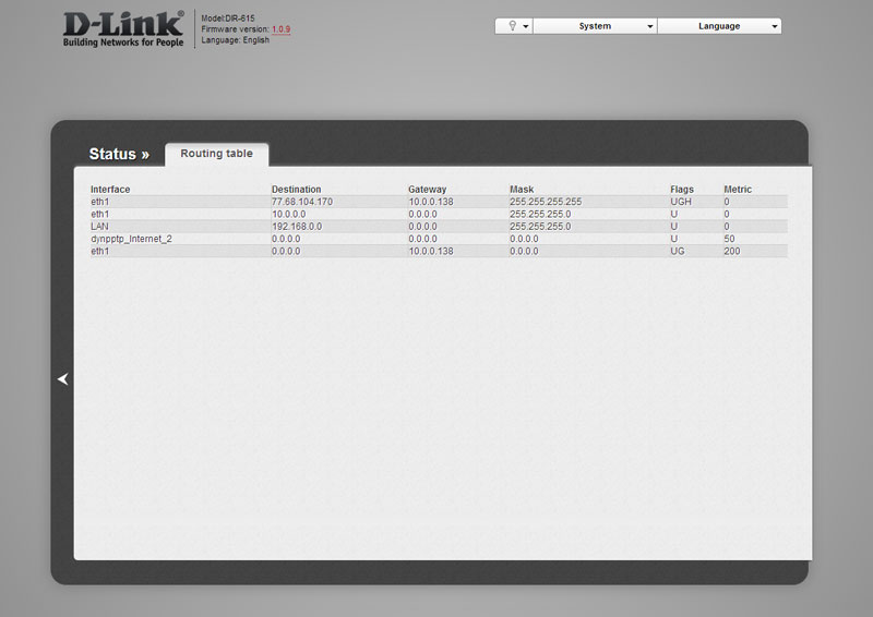

I have been unable to set up a Dynamic PPTP connection using a DIR 615 M1 with 1.0.9 firmware. The routing table shows incorrect entries with the PPTP destination showing as 0.0.0.0 and the correct PPTP destination listed under eth1.
Комментарий к файлу: Routing table
routing-table-for-failed-PP.jpg [ 39 KiB | Просмотров: 5866 ]

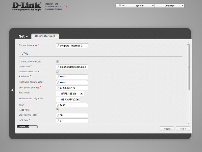

Комментарий к файлу: PPTP setup
VPN.jpg [ 49.33 KiB | Просмотров: 5866 ]

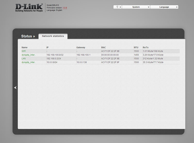

No. May be you have wrong information about encryption or authentication algorithm? Did you restore your device to factory settings after upgrade the firmware? Please, show an image of network statistics.

The encryption or authentication algorithms are those specified by the VPN supplier - and work correctly with a DIR 300. I have restored the factory settings. Please explain why the router table seems to have incorrect entries.
Комментарий к файлу: Network statistics page
network-statistics-for-fail.jpg [ 43.18 KiB | Просмотров: 5854 ]

However, the only difference now is that a few more packets of data are passed via the PPTP connection before the connection freezes. Previously I could only manage to logon to the BBC iPlayer TV site before the connection froze - but now I get a little further with the error message of not being in the UK (so the connection was not actually using my UK VPN). I note also that the router connection table is still wrong. After a power on reset the router behaves in the same way with the ability to pass just a few packets of data and then freezing. I should emphasize that using exactly the same configuration settings on my DIR 130 I have no trouble accessing the iPlayer TV site from Israel. My PPTP connection is using MPPE 128 bit and MSChap V2 authentication.
