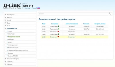

Здравствуйте, неваляшка продолжается, постоянно рвет сессию. Не понятно почему дергает 4 порт, хотя он в настройках вообще выключен,
dl.JPG [ 60.42 KiB | Просмотров: 6665 ]
на дату и время не обращайте внимание, роутер на ночь выключается из сети.
Jan 3 20:02:58 kernel: enum_acl_netdev: got 2 ifaces (1 LAN, 1 WAN)
Jan 3 20:02:58 dms_reset_uptime[26248]: enter key wan1_2
Jan 3 20:02:58 kernel: enum_acl_netdev: need 6 patterns instead of 6
Jan 3 20:02:59 kernel: ESW: Link Status Changed - Port4 Link UP
Jan 3 20:02:59 kernel: ESW: Link Status Changed - Port4 Link Down
Jan 3 20:03:00 kernel: ESW: Link Status Changed - Port4 Link UP
Jan 3 20:03:00 kernel: ESW: Link Status Changed - Port4 Link Down
Jan 3 20:03:04 kernel: ESW: Link Status Changed - Port4 Link UP
Jan 3 20:03:06 udhcpc[26293]: UDHCP start..
Jan 3 20:03:06 udhcpc[26293]: udhcp client (v0.9.8) started (iface: wan1, connect: 2)
Jan 3 20:03:07 kernel: enum_acl_netdev: got 2 ifaces (1 LAN, 1 WAN)
Jan 3 20:03:09 kernel: ESW: Link Status Changed - Port4 Link Down
Jan 3 20:03:11 kernel: ESW: Link Status Changed - Port4 Link UP
Jan 3 20:03:11 kernel: ESW: Link Status Changed - Port4 Link Down
Jan 3 20:03:12 kernel: ESW: Link Status Changed - Port4 Link UP
Jan 3 20:03:12 kernel: ESW: Link Status Changed - Port4 Link Down
Jan 4 03:03:14 kernel: ESW: Link Status Changed - Port4 Link UP
Jan 4 03:03:15 kernel: ESW: Link Status Changed - Port4 Link Down
Jan 4 03:03:16 udhcpc[26293]: Received SIGTERM
Jan 4 03:03:17 kernel: enum_acl_netdev: got 2 ifaces (1 LAN, 1 WAN)
Jan 4 03:03:17 dms_reset_uptime[26342]: enter key wan1_2
Jan 4 03:03:17 dms_reset_uptime[26342]: unable to remove file /tmp/stat.wan1_2
Jan 4 03:03:19 kernel: ESW: Link Status Changed - Port4 Link UP
Jan 4 03:03:20 udhcpc[26370]: UDHCP start..
Jan 4 03:03:20 udhcpc[26370]: udhcp client (v0.9.8) started (iface: wan1, connect: 2)
Jan 4 03:03:21 kernel: enum_acl_netdev: got 2 ifaces (1 LAN, 1 WAN)
Jan 4 03:03:21 udhcpc[26370]: Sending discover...
Jan 4 03:03:22 udhcpc[26370]: Lease of 172.18.ххх.ххх obtained, lease time 3600
Jan 4 03:03:23 igmpx[26428]: upstream ifaces: ^A
Jan 4 03:03:23 igmpx[26428]: downstream ifaces: br0
Jan 4 03:03:23 igmpx[26428]: hews interval = 120.0 sec
Jan 4 03:03:23 igmpx[26428]: doublet join enabled
Jan 4 03:03:23 igmpx[26428]: Using old argv style
Jan 4 03:03:23 igmpx[26428]: daemonizing ...
Jan 4 03:03:23 igmpx[26429]: current prio is -20
Jan 4 03:03:23 igmpx[26429]: kernel multicast version is 305 (v3.05 ?)
Jan 4 03:03:23 igmpx[26429]: kernel mroute inited
Jan 4 03:03:23 igmpx[26429]: proxy prepared
Jan 4 03:03:23 igmpx[26429]: ioctl: get iface index: ^A: 19(No such device)
Jan 4 03:03:23 igmpx[26429]: vifi #0 added for br0
Jan 4 03:03:23 igmpx[26429]: valid VIF's configured: upstreams=0, downstreams=1. Bad.
Jan 4 03:03:24 NAT hazards[837]: 0 discovered
Jan 4 03:03:26 kernel: ESW: Link Status Changed - Port4 Link Down
Jan 4 03:03:28 kernel: ESW: Link Status Changed - Port4 Link UP
Jan 4 03:03:31 kernel: ESW: Link Status Changed - Port4 Link Down
Jan 4 03:03:33 kernel: ESW: Link Status Changed - Port4 Link UP
Jan 4 03:03:33 kernel: ESW: Link Status Changed - Port4 Link Down
Jan 4 03:03:35 kernel: ESW: Link Status Changed - Port4 Link UP
Jan 4 03:03:35 kernel: ESW: Link Status Changed - Port4 Link Down
Jan 4 03:03:37 kernel: ESW: Link Status Changed - Port4 Link UP
Jan 4 03:03:41 kernel: ESW: Link Status Changed - Port4 Link UP
Jan 4 03:03:41 kernel: ESW: Link Status Changed - Port4 Link Down
Jan 4 03:03:43 kernel: ESW: Link Status Changed - Port4 Link UP
