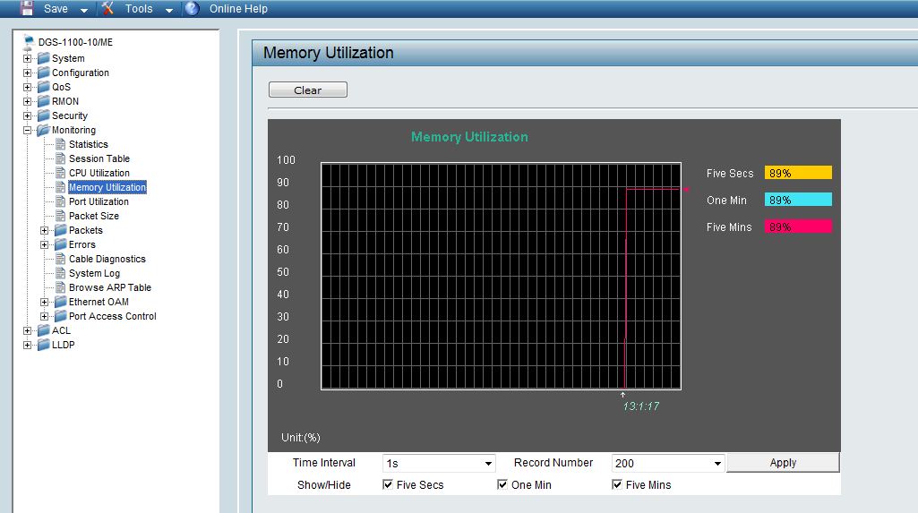

По какой причине через Java (Packet Size) в WEB не отображается?

Это проблема с Java на Вашем ПК. Добавьте адрес коммутатора в список исключений Java Security.

На всех остальных коммутаторах другой модели отображается без вопросов в разных браузерах. В случае с 1100-10/ME, нет.
Java Plug-in 1.6.0_23
Using JRE version 1.6.0_23-b05 Java HotSpot(TM) Client VM
User home directory = C:\Users\Office
c: clear console window
f: finalize objects on finalization queue
g: garbage collect
h: display this help message
l: dump classloader list
m: print memory usage
o: trigger logging
q: hide console
r: reload policy configuration
s: dump system and deployment properties
t: dump thread list
v: dump thread stack
x: clear classloader cache
0-5: set trace level to <n>
java.lang.UnsupportedClassVersionError: MultipleLineChart : Unsupported major.minor version 51.0
at java.lang.ClassLoader.defineClass1(Native Method)
at java.lang.ClassLoader.defineClassCond(Unknown Source)
at java.lang.ClassLoader.defineClass(Unknown Source)
at java.security.SecureClassLoader.defineClass(Unknown Source)
at java.net.URLClassLoader.defineClass(Unknown Source)
at sun.reflect.NativeMethodAccessorImpl.invoke0(Native Method)
at sun.reflect.NativeMethodAccessorImpl.invoke(Unknown Source)
at sun.reflect.DelegatingMethodAccessorImpl.invoke(Unknown Source)
at java.lang.reflect.Method.invoke(Unknown Source)
at sun.plugin2.applet.Plugin2ClassLoader.defineClassHelper(Unknown Source)
at sun.plugin2.applet.Plugin2ClassLoader.access$100(Unknown Source)
at sun.plugin2.applet.Plugin2ClassLoader$2.run(Unknown Source)
at java.security.AccessController.doPrivileged(Native Method)
at sun.plugin2.applet.Plugin2ClassLoader.findClassHelper(Unknown Source)
at sun.plugin2.applet.Applet2ClassLoader.findClass(Unknown Source)
at sun.plugin2.applet.Plugin2ClassLoader.loadClass0(Unknown Source)
at sun.plugin2.applet.Plugin2ClassLoader.loadClass(Unknown Source)
at java.lang.ClassLoader.loadClass(Unknown Source)
at sun.plugin2.applet.Plugin2ClassLoader.loadCode(Unknown Source)
at sun.plugin2.applet.Plugin2Manager.createApplet(Unknown Source)
at sun.plugin2.applet.Plugin2Manager$AppletExecutionRunnable.run(Unknown Source)
at java.lang.Thread.run(Unknown Source)
Exception: java.lang.UnsupportedClassVersionError: MultipleLineChart : Unsupported major.minor version 51.0
s2.png [ 204.84 KiB | Просмотров: 9358 ]
s.png [ 155.58 KiB | Просмотров: 9358 ]

На стенде никаких проблем. Браузер - IE. версия Java - последняя.
DGS-1100-10.JPG [ 92.61 KiB | Просмотров: 9354 ]
Действительно проблема в устаревшей версии Java. Минус новой Java в том, что надо адрес каждого коммутатор добавлять в белый список.
