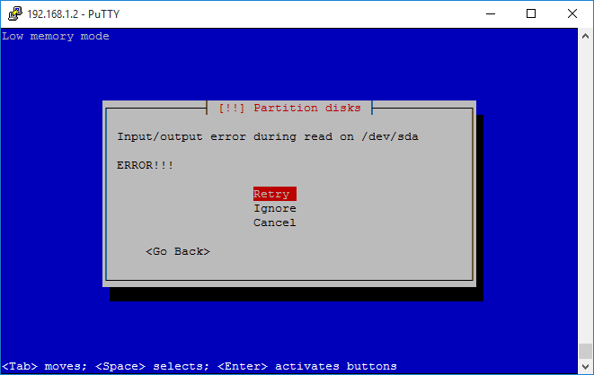

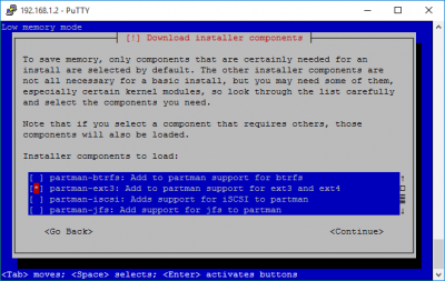

Господа, реанимирую тему:
Девайс: DNS-323 A1.
Залил netboot.ini
Зашел на девайс по SSH. Прошел все до разбивки диска на партишены.
Но не сохраняет изменения на диске (скриншоты прилагаю)
Если установить fdisk и parted (при конфигурации installer-a), то они выдают следующее:
fdisk -l /dev/sda
fdisk: cannot open /dev/sda: Input/output error
parted /dev/sda
GNU Parted 3.2
Using /dev/sda
Welcome to GNU Parted! Type 'help' to view a list of commands.
(parted) print
print
Error: /dev/sda: unrecognised disk label
Model: ATA ST380815AS (scsi)
Disk /dev/sda: 80.0GB
Sector size (logical/physical): 512B/512B
Partition Table: unknown
Disk Flags:
(parted) mklabel msdos
mklabel msdos
Error: Input/output error during read on /dev/sda
Retry/Ignore/Cancel?
Диски пробовал разные, и на 2 Tb, и на 80 Gb
Вот что в логе после выполнения fdisk:
~ # fdisk -l /dev/sda
~ # tail /var/log/syslog
Oct 17 10:01:46 kernel: [  679.104549] ata1: SATA link up 1.5 Gbps (SStatus 113 SControl 310)
Oct 17 10:01:46 kernel: [  679.136634] ata1.00: configured for UDMA/33
Oct 17 10:01:46 kernel: [  679.136725] ata1: EH complete
Oct 17 10:01:46 kernel: [  679.144631] ata1.00: exception Emask 0x10 SAct 0x80 SErr 0x0 action 0x6 frozen
Oct 17 10:01:46 kernel: [  679.144666] ata1.00: edma_err_cause=00000280 pp_flags=00000003, parity error, EDMA self-disable
Oct 17 10:01:46 kernel: [  679.144699] ata1.00: failed command: READ FPDMA QUEUED
Oct 17 10:01:46 kernel: [  679.144762] ata1.00: cmd 60/08:38:00:00:00/00:00:00:00:00/40 tag 7 ncq 4096 in
Oct 17 10:01:46 kernel: [  679.144762]          res 50/00:ff:ff:ff:ff/00:ff:ff:ff:ff/ff Emask 0x10 (ATA bus error)
Oct 17 10:01:46 kernel: [  679.144792] ata1.00: status: { DRDY }
Oct 17 10:01:46 kernel: [  679.144835] ata1: hard resetting link
~ # fdisk -l /dev/sdb
fdisk: cannot open /dev/sdb: Input/output error
Oct 17 10:09:45 kernel: [ 1158.288614] ata2.00: configured for UDMA/33
Oct 17 10:09:45 kernel: [ 1158.288703] ata2: EH complete
Oct 17 10:09:45 kernel: [ 1158.296632] ata2.00: exception Emask 0x10 SAct 0x20000 SErr 0x0 action 0x6 frozen
Oct 17 10:09:45 kernel: [ 1158.296667] ata2.00: edma_err_cause=00000280 pp_flags=00000003, parity error, EDMA self-disable
Oct 17 10:09:45 kernel: [ 1158.296703] ata2.00: failed command: READ FPDMA QUEUED
Oct 17 10:09:45 kernel: [ 1158.296767] ata2.00: cmd 60/08:88:08:00:00/00:00:00:00:00/40 tag 17 ncq 4096 in
Oct 17 10:09:45 kernel: [ 1158.296767]          res 50/00:ff:ff:ff:ff/00:ff:ff:ff:ff/ff Emask 0x10 (ATA bus error)
Oct 17 10:09:45 kernel: [ 1158.296798] ata2.00: status: { DRDY }
Oct 17 10:09:45 kernel: [ 1158.296835] ata2: hard resetting link
Oct 17 10:09:46 kernel: [ 1158.772555] ata2: SATA link up 1.5 Gbps (SStatus 113 SControl 310)

Насколько помню там перевернутые названия дисков
да перешел на Alt-F все устраивает

ЗЫ: Нашел вот тут интересный абзац:
And the 3.10 kernel in wheeze-backports and 3.11 kernel in Debian Testing (Jessie), have yet another error: they get stuck in a loop trying to talk to the hard drives, receiving errors (or messages they can't parse) from the hard drives. So it really works best to stick with kernel 2.6.32.
По-моему, как раз моя проблема.
Но где ж теперь взять старую версию 2.6.32 инсталлера (netboot.img)?
