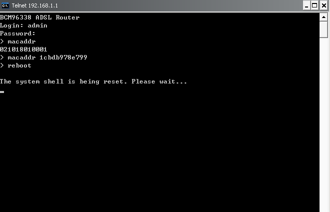

hamid_inet писал(а):
qwasi писал(а):
Так и не понял - обновляли уже прошивку или нет, но на всякий случай:
You will renew firmware to the last version (1.24). Since a version 1.22 this bug is fixed (you can check the changelog).
For DSL-2640U/BRU/C (H/W: C1)
ftp://ftp.dlink.ru/pub/ADSL/DSL-2640U_B ... 100607.zip
P.S I hope your English better....:)
i'm not Russian so i get help with Google translator to type.
i updated to latest version (1.24) but have seen that in some cases modem returns back to that mac address.i think the firmware has a problem
Please kindly try to change mac-address via CLI:
Step1: Open telnet 192.168.1.1
Step2: Input device's user name and password
Step3:Type command “macaddr [mac address]”
Mac address -- you can find it on the back of the device which is print in the label
Step4: Reboot device
mac.png [ 5.46 KiB | Просмотров: 5814 ]
