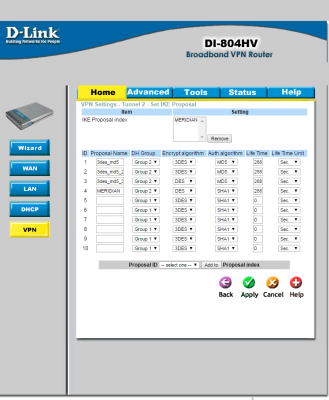

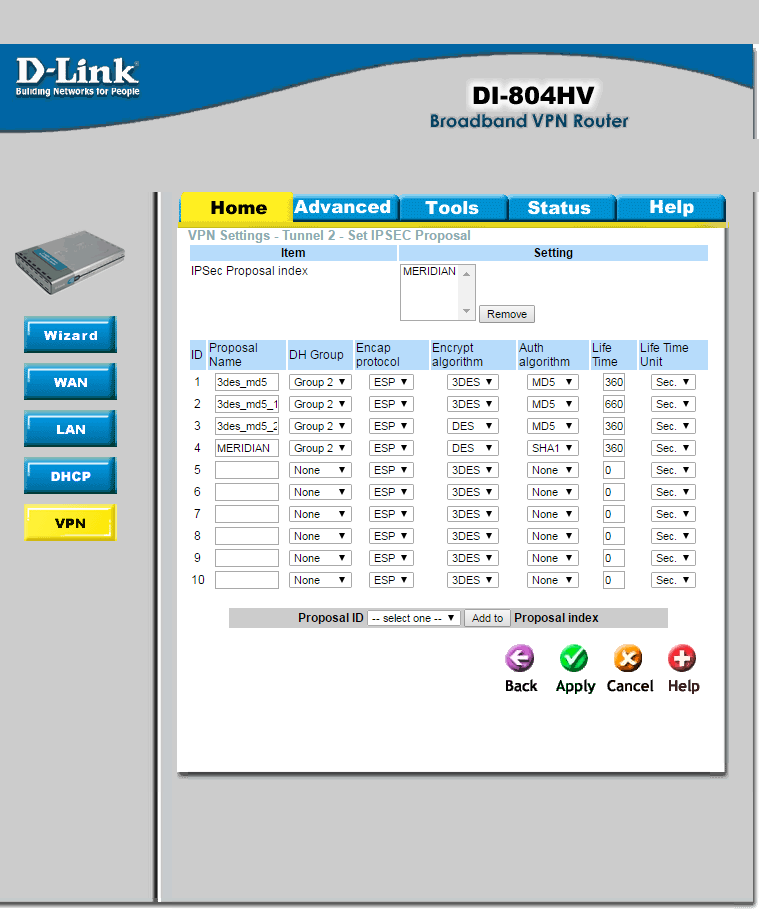

Здравствуйте. Никак не получается поднять тунель между устройствами Dir-140l и DI-804HV. Три тунеля между одинаковыми моделями все работает отлично, но между разными не получается. Прикладываю настройки DI-804HV и вот его лог:
Tuesday August 25, 2009 03:10:15 IKED re-TX : IDINIT to 195.88.179.134
Tuesday August 25, 2009 03:10:20 IKED re-TX : IDINIT to 195.88.179.134
Tuesday August 25, 2009 03:10:29 receiving a re-Tx MM msg, response the last msg
Tuesday August 25, 2009 03:10:29 IKED re-TX : MM to 195.88.179.134
Tuesday August 25, 2009 03:10:39 IKED re-TX : IDINIT to 195.88.179.134
Tuesday August 25, 2009 03:10:50 receiving a re-Tx MM msg, response the last msg
Tuesday August 25, 2009 03:10:50 IKED re-TX : MM to 195.88.179.134
Tuesday August 25, 2009 03:10:51 Send IKE (INFO) : delete 77.82.81.247 -> 195.88.179.134 phase 1
Tuesday August 25, 2009 03:10:51 IKE phase1 (ISAKMP SA) remove : 77.82.81.247 <-> 195.88.179.134
Tuesday August 25, 2009 03:10:51 Send IKE M1(INIT) : 77.82.81.247 --> 195.88.179.134
Tuesday August 25, 2009 03:10:51 Receive IKE M2(RESP) : 195.88.179.134 --> 77.82.81.247
Tuesday August 25, 2009 03:10:51 Try to match with ENC:DES AUTH:PSK HASH:SHA1 Group:Group2
Tuesday August 25, 2009 03:10:51 Send IKE M3(KEYINIT) : 77.82.81.247 --> 195.88.179.134
Tuesday August 25, 2009 03:10:51 Receive IKE M4(KEYRESP) : 195.88.179.134 --> 77.82.81.247
Tuesday August 25, 2009 03:10:51 Send IKE M5(IDINIT) : 77.82.81.247 --> 195.88.179.134
Tuesday August 25, 2009 03:10:57 IKED re-TX : IDINIT to 195.88.179.134
Tuesday August 25, 2009 03:11:00 Disassociated: Blocked access attempt from 77.82.19.142:25753 to TCP port 23
Tuesday August 25, 2009 03:11:02 IKED re-TX : IDINIT to 195.88.179.134
Tuesday August 25, 2009 03:11:12 IKED re-TX : IDINIT to 195.88.179.134
Tuesday August 25, 2009 03:11:12 receiving a re-Tx MM msg, response the last msg
