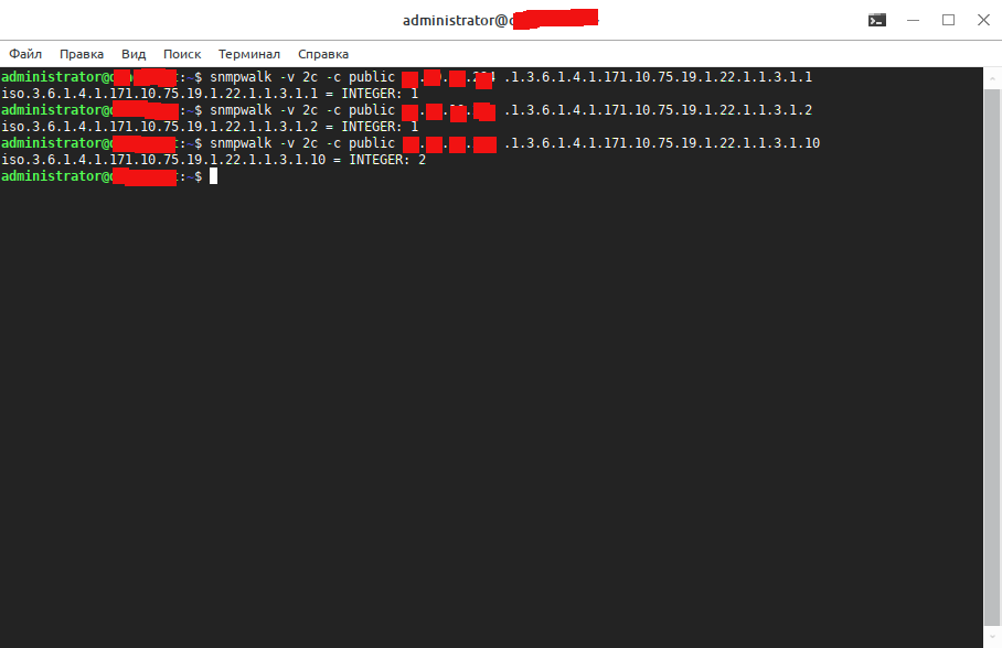

MIB: DES-1210-28P_CX
OID: .1.3.6.1.4.1.171.10.75.19.1.22.1.1.3
Syntax: INTEGER {enabled (1),disabled (2)}
Name/OID: poePortSettingState.1.1; Value (Integer): enabled (1)
Name/OID: poePortSettingState.1.2; Value (Integer): enabled (1)
Name/OID: poePortSettingState.1.3; Value (Integer): enabled (1)
Name/OID: poePortSettingState.1.20; Value (Integer): disabled (2)
Name/OID: poePortSettingState.1.21; Value (Integer): disabled (2)
snmp-001.png [ 37.06 KiB | Просмотров: 4531 ]
