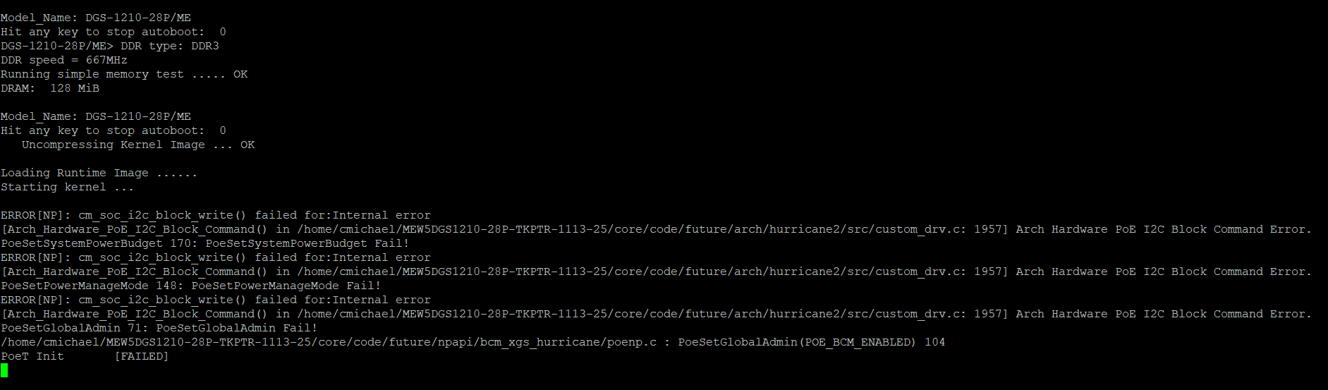

When I restart the switch I get error
"Loading Runtime Image ......
Starting kernel ...
ERROR[NP]: cm_soc_i2c_block_write() failed for:Internal error
[Arch_Hardware_PoE_I2C_Block_Command() in /home/cmichael/MEW5DGS1210-28P-TKPTR-1113-25/core/code/future/arch/hurricane2/src/custom_drv.c: 1957] Arch Hardware PoE I2C Block Command Error.
PoeSetSystemPowerBudget 170: PoeSetSystemPowerBudget Fail!
PoeSetPowerManageMode 148: PoeSetPowerManageMode Fail!
PoeSetGlobalAdmin 71: PoeSetGlobalAdmin Fail!
/home/cmichael/MEW5DGS1210-28P-TKPTR-1113-25/core/code/future/npapi/bcm_xgs_hurricane/poenp.c : PoeSetGlobalAdmin(POE_BCM_ENABLED) 104
PoeT Init [FAILED]
unit 0 ECC enable

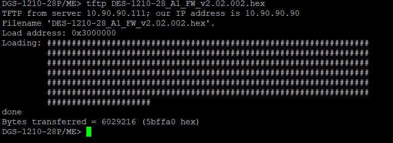

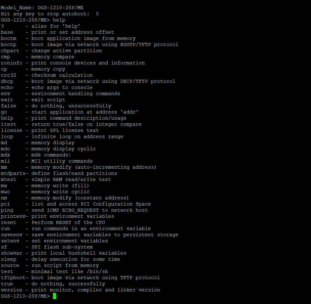

I try to download the firmware from TFTP server get the file but do not know what to do next....

First of all have a check which HW ver do you have.
Firmware for A1
]Firmware for B1
Then try to download fw via tftp and use "bootm" command for booting with this file.
